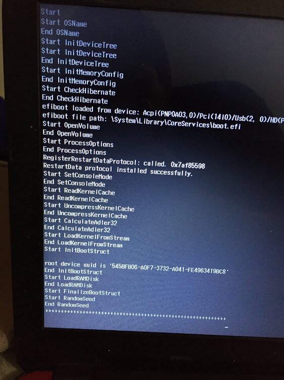

hola_3.1416 Posted December 19, 2018 Share Posted December 19, 2018 can anyone help me i´m getting this error something like "finished seeding" and at the end "+++++++++++++++++++++++++++++++" help please Added in 1 minute 9 seconds: trying to install mojave, on my hp i5 6200 Quote Link to comment Share on other sites More sharing options...

Administrators MaLd0n Posted December 20, 2018 Author Administrators Share Posted December 20, 2018 [ref]hola_3.1416[/ref], try with aptiov3 intead aptiomemoryfix Added in 44 seconds: [ref]imran.sefat[/ref], i think ur notebook is optimus, use config2.plist in Olarila images Quote -Donations- PayPal HERE - Stripe HERE - Ko-Fi HERE - BuyMeaCoffee HERE - Mercado Livre HERE Skrill danielnmaldonado@gmail.com - BTC 33HeGCuCSh4tUBqdYkQqKpSDa1E7WeAJQ3 - BNB 0x10D1d656eCa00bD521f9b4A43B83098B8142e115 - USDT BSC BEP20 0xb57cfdfa371fad1981910f0e8332409ab99f74d9 - USDT TRC20 TUR6Z9AVS4AYzqPnULoHrfFvppRbhXmNbZ - KASPA kaspa:qpxzufgfj8p6r0krg58yzvs0009h2mwqgvcawa0xc2pth7sgzpv56j4f6dtvk - PicPay @danielnmaldonado - PiX @danielnmaldonado@gmail.com Premium Users HERE - Problems with Paypal HERE Sign up for a Bybit account and claim exclusive rewards HERE New ways to earn money with Linkvertise HERE Link to comment Share on other sites More sharing options...
