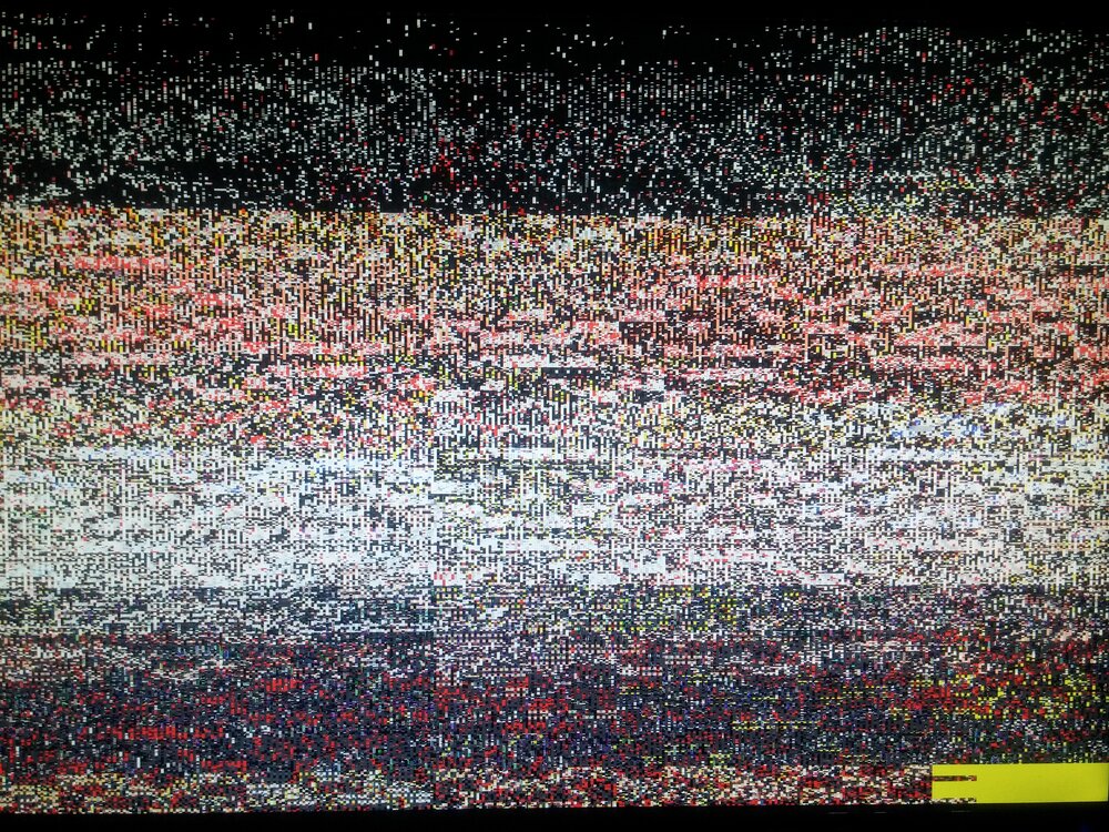

preben Posted December 14, 2018 Share Posted December 14, 2018 (edited) I get black or yellow screen after verbose boot. I installed Olarila Mojave 10.14.1. I attach my original dsdt. Let me know if you need more information. PS: Where do I have to put modified dsdt? Send me iMac-of-preben.zip Edited December 14, 2018 by Guest Quote Link to comment Share on other sites More sharing options...
Administrators MaLd0n Posted December 14, 2018 Administrators Share Posted December 14, 2018 [ref]gnodhn[/ref], DSDT.aml.zip USB https://Olarila.com/forum/viewtopic.php?p=65287#p65287 Added in 4 minutes 15 seconds: [ref]preben[/ref], USE IT DSDT.aml.zip *put ur GPU in first slot x16, now ur GPU run at x1 DSDT.aml.zip Quote -Donations- PayPal HERE - Stripe HERE - Ko-Fi HERE - BuyMeaCoffee HERE - Mercado Livre HERE Skrill [email protected] BTC 1BDzsV4bw3DVCiffFAeNKsdEzqkPXNVrXR ETH BSC BEP20 0xb57cfdfa371fad1981910f0e8332409ab99f74d9 BNB 0x10D1d656eCa00bD521f9b4A43B83098B8142e115 USDT BSC BEP20 0xb57cfdfa371fad1981910f0e8332409ab99f74d9 USDT TRC20 TUR6Z9AVS4AYzqPnULoHrfFvppRbhXmNbZ PicPay @danielnmaldonado PiX @[email protected] Problems with Paypal HERE Sign up for a Bybit account and claim exclusive rewards HERE New ways to earn money with Linkvertise HERE Link to comment Share on other sites More sharing options...
preben Posted December 14, 2018 Share Posted December 14, 2018 [ref]gnodhn[/ref], DSDT.aml.zip USB https://Olarila.com/forum/viewtopic.php?p=65287#p65287 Added in 4 minutes 15 seconds: [ref]preben[/ref], USE IT DSDT.aml.zip *put ur GPU in first slot x16, now ur GPU run at x1 Â Thanks for reply and modified dsdt. The video card is in 1x slot cause in 16x slot the pc rebooted by itself. Anyway, now I get screenshot in attachment. Quote Link to comment Share on other sites More sharing options...
Administrators MaLd0n Posted December 14, 2018 Administrators Share Posted December 14, 2018 [ref]preben[/ref], what GPU model? Quote -Donations- PayPal HERE - Stripe HERE - Ko-Fi HERE - BuyMeaCoffee HERE - Mercado Livre HERE Skrill [email protected] BTC 1BDzsV4bw3DVCiffFAeNKsdEzqkPXNVrXR ETH BSC BEP20 0xb57cfdfa371fad1981910f0e8332409ab99f74d9 BNB 0x10D1d656eCa00bD521f9b4A43B83098B8142e115 USDT BSC BEP20 0xb57cfdfa371fad1981910f0e8332409ab99f74d9 USDT TRC20 TUR6Z9AVS4AYzqPnULoHrfFvppRbhXmNbZ PicPay @danielnmaldonado PiX @[email protected] Problems with Paypal HERE Sign up for a Bybit account and claim exclusive rewards HERE New ways to earn money with Linkvertise HERE Link to comment Share on other sites More sharing options...
preben Posted December 14, 2018 Share Posted December 14, 2018 [ref]preben[/ref], what GPU model? Â HD7750. To try, I initialized disk, repeated installation and put dsdt.aml in EFI/Clover/ACPI/patched: Is It the right folder? Now the screen is whole yellow: a little step ahead... Quote Link to comment Share on other sites More sharing options...
Administrators MaLd0n Posted December 14, 2018 Administrators Share Posted December 14, 2018 [ref]preben[/ref], serie 7xxx use flag radpg=15 and WEG kext Quote -Donations- PayPal HERE - Stripe HERE - Ko-Fi HERE - BuyMeaCoffee HERE - Mercado Livre HERE Skrill [email protected] BTC 1BDzsV4bw3DVCiffFAeNKsdEzqkPXNVrXR ETH BSC BEP20 0xb57cfdfa371fad1981910f0e8332409ab99f74d9 BNB 0x10D1d656eCa00bD521f9b4A43B83098B8142e115 USDT BSC BEP20 0xb57cfdfa371fad1981910f0e8332409ab99f74d9 USDT TRC20 TUR6Z9AVS4AYzqPnULoHrfFvppRbhXmNbZ PicPay @danielnmaldonado PiX @[email protected] Problems with Paypal HERE Sign up for a Bybit account and claim exclusive rewards HERE New ways to earn money with Linkvertise HERE Link to comment Share on other sites More sharing options...
preben Posted December 14, 2018 Share Posted December 14, 2018 [ref]preben[/ref], serie 7xxx use flag radpg=15 and WEG kext  WhateverGreen.kext is already inside EFI\CLOVER\kexts\Other folder. I'll try asap radpg=15. Quote Link to comment Share on other sites More sharing options...

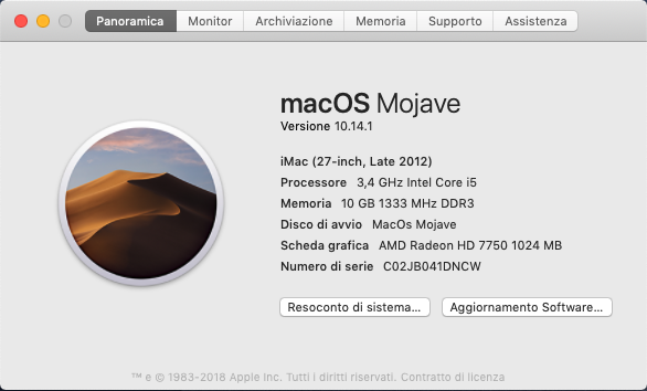

preben Posted December 14, 2018 Share Posted December 14, 2018 Thanks for suggestions. Now It works. At the moment I manage to boot only with clover, inside usb installer. I have installed clover on installation disk without result. Doesn't clover support apfs/mojave yet ? Let me know. Quote Link to comment Share on other sites More sharing options...

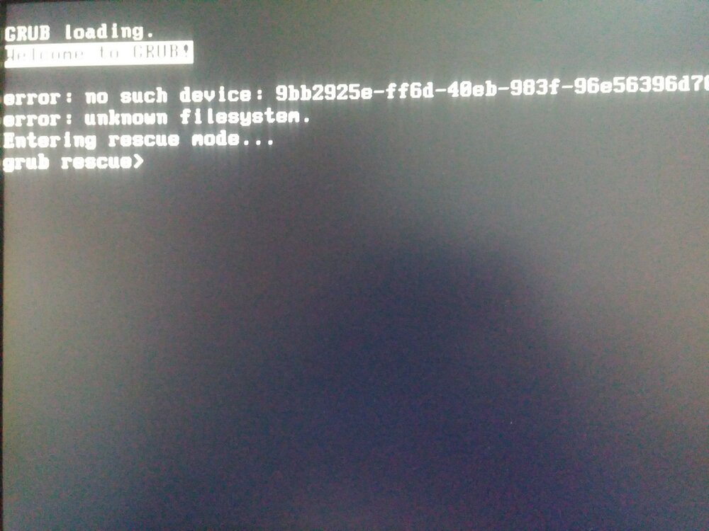

preben Posted December 14, 2018 Share Posted December 14, 2018 Done, but with windows/linux disk connected(uefi) I get these rows: Quote Link to comment Share on other sites More sharing options...

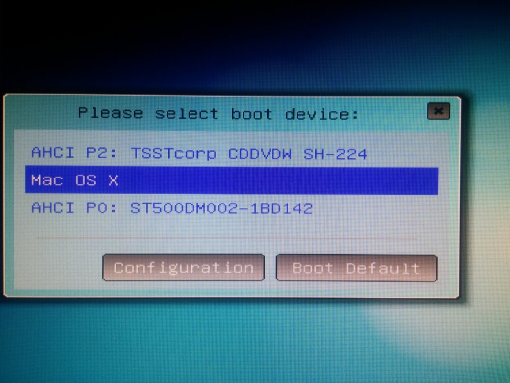

preben Posted December 14, 2018 Share Posted December 14, 2018 This is boot device selection. I don't know where I get "mac os x" voice. Quote Link to comment Share on other sites More sharing options...
Administrators MaLd0n Posted December 15, 2018 Administrators Share Posted December 15, 2018 [ref]preben[/ref], i dont use grub, linux etc, but here in forum, oldnapalm have a amazing tutorials about multiboot Quote -Donations- PayPal HERE - Stripe HERE - Ko-Fi HERE - BuyMeaCoffee HERE - Mercado Livre HERE Skrill [email protected] BTC 1BDzsV4bw3DVCiffFAeNKsdEzqkPXNVrXR ETH BSC BEP20 0xb57cfdfa371fad1981910f0e8332409ab99f74d9 BNB 0x10D1d656eCa00bD521f9b4A43B83098B8142e115 USDT BSC BEP20 0xb57cfdfa371fad1981910f0e8332409ab99f74d9 USDT TRC20 TUR6Z9AVS4AYzqPnULoHrfFvppRbhXmNbZ PicPay @danielnmaldonado PiX @[email protected] Problems with Paypal HERE Sign up for a Bybit account and claim exclusive rewards HERE New ways to earn money with Linkvertise HERE Link to comment Share on other sites More sharing options...
