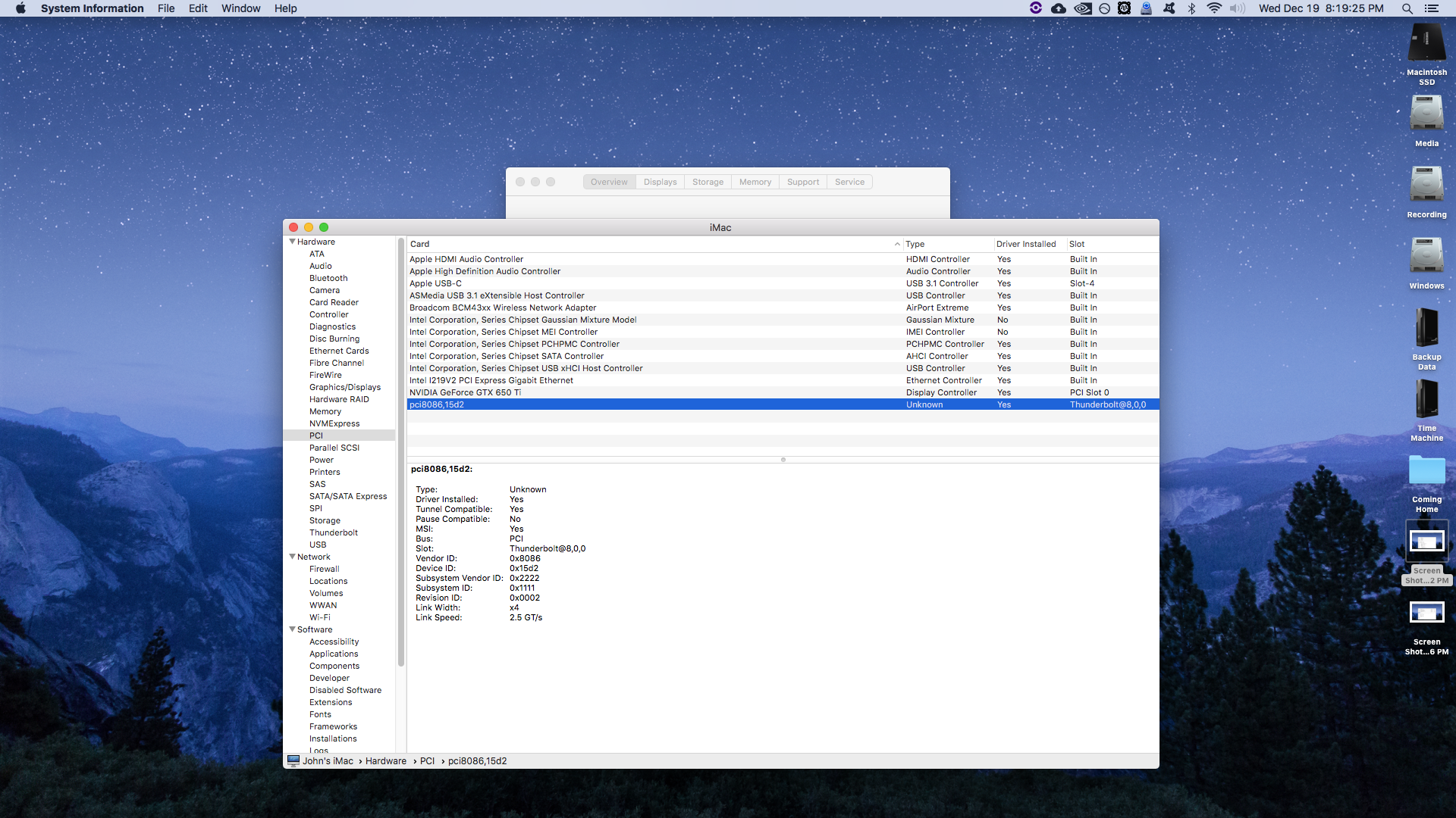

Johnnyhobbs Posted December 19, 2018 Share Posted December 19, 2018 [ref]Johnnyhobbs[/ref], take one shot, use power button for wake DSDT.aml.zip disable hibernate, use only sleep https://Olarila.com/files/Utils/disablehibernate.command.zip We're going to need a few more shots. Still won't sleep Quote Link to comment Share on other sites More sharing options...
Administrators MaLd0n Posted December 19, 2018 Administrators Share Posted December 19, 2018 [ref]Johnnyhobbs[/ref], i think is tbh card, i think i see one topic about it in InsanelyMac, i'll check Quote -Donations- PayPal HERE - Stripe HERE - Ko-Fi HERE - BuyMeaCoffee HERE - Mercado Livre HERE Skrill [email protected] BTC 1BDzsV4bw3DVCiffFAeNKsdEzqkPXNVrXR ETH BSC BEP20 0xb57cfdfa371fad1981910f0e8332409ab99f74d9 BNB 0x10D1d656eCa00bD521f9b4A43B83098B8142e115 USDT BSC BEP20 0xb57cfdfa371fad1981910f0e8332409ab99f74d9 USDT TRC20 TUR6Z9AVS4AYzqPnULoHrfFvppRbhXmNbZ PicPay @danielnmaldonado PiX @[email protected] Problems with Paypal HERE Sign up for a Bybit account and claim exclusive rewards HERE New ways to earn money with Linkvertise HERE Link to comment Share on other sites More sharing options...

Johnnyhobbs Posted December 20, 2018 Share Posted December 20, 2018 (edited) [ref]Johnnyhobbs[/ref], the patches is just cosmetics and hot plug problem, ur problem is sleep, but i think is about is TBH card, yes  The hot plug patch would be useful, but definitely want to solve sleep first. Here's my clover folder. I also tested again and the system sleeps fine when there's no DSDT Edited December 20, 2018 by Guest Quote Link to comment Share on other sites More sharing options...

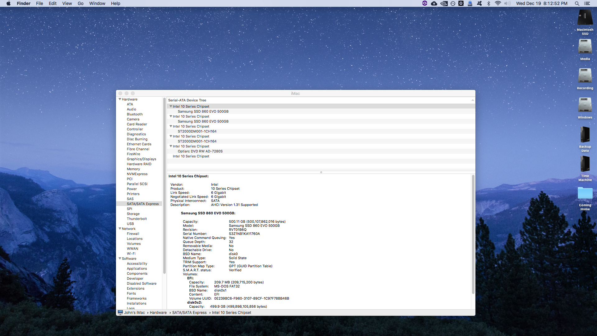

Johnnyhobbs Posted December 20, 2018 Share Posted December 20, 2018 [ref]Johnnyhobbs[/ref], 1- DSDT.Without Firewire.zip 2- DSDT.Firewire.zip That's what it was! DSDT with FW = No sleep. DSDT w/o FW = Sleep! Thank you so much. Just couple cosmetic things though. I have a Z370 motherboard, so can the SATA devices pages show 30 Series instead of 10 Series? And is there a way to change the way the Thunderbolt device is being reported? Quote Link to comment Share on other sites More sharing options...
Administrators MaLd0n Posted December 20, 2018 Administrators Share Posted December 20, 2018 [ref]Johnnyhobbs[/ref], is the last vanilla id Quote -Donations- PayPal HERE - Stripe HERE - Ko-Fi HERE - BuyMeaCoffee HERE - Mercado Livre HERE Skrill [email protected] BTC 1BDzsV4bw3DVCiffFAeNKsdEzqkPXNVrXR ETH BSC BEP20 0xb57cfdfa371fad1981910f0e8332409ab99f74d9 BNB 0x10D1d656eCa00bD521f9b4A43B83098B8142e115 USDT BSC BEP20 0xb57cfdfa371fad1981910f0e8332409ab99f74d9 USDT TRC20 TUR6Z9AVS4AYzqPnULoHrfFvppRbhXmNbZ PicPay @danielnmaldonado PiX @[email protected] Problems with Paypal HERE Sign up for a Bybit account and claim exclusive rewards HERE New ways to earn money with Linkvertise HERE Link to comment Share on other sites More sharing options...

Johnnyhobbs Posted December 20, 2018 Share Posted December 20, 2018 [ref]Johnnyhobbs[/ref], the command just check dont mnod nothing take one shot DSDT.aml.zip Okay was just making sure i didn't need to undo the diablehibernate command. Thunderbolt shows up good now! The SATA device tree still shows 10 Series Intel Chipset instead of 30 though Quote Link to comment Share on other sites More sharing options...
Administrators MaLd0n Posted December 20, 2018 Administrators Share Posted December 20, 2018 [ref]Johnnyhobbs[/ref], with DSDT only serie 10, the original kext apple stay in serie 10 Quote -Donations- PayPal HERE - Stripe HERE - Ko-Fi HERE - BuyMeaCoffee HERE - Mercado Livre HERE Skrill [email protected] BTC 1BDzsV4bw3DVCiffFAeNKsdEzqkPXNVrXR ETH BSC BEP20 0xb57cfdfa371fad1981910f0e8332409ab99f74d9 BNB 0x10D1d656eCa00bD521f9b4A43B83098B8142e115 USDT BSC BEP20 0xb57cfdfa371fad1981910f0e8332409ab99f74d9 USDT TRC20 TUR6Z9AVS4AYzqPnULoHrfFvppRbhXmNbZ PicPay @danielnmaldonado PiX @[email protected] Problems with Paypal HERE Sign up for a Bybit account and claim exclusive rewards HERE New ways to earn money with Linkvertise HERE Link to comment Share on other sites More sharing options...
Johnnyhobbs Posted December 20, 2018 Share Posted December 20, 2018 [ref]Johnnyhobbs[/ref], with DSDT only serie 10, the original kext apple stay in serie 10 Got it. All right man, thank you! Enjoy that beer! I’ll be taking some shots in celebration. Quote Link to comment Share on other sites More sharing options...
