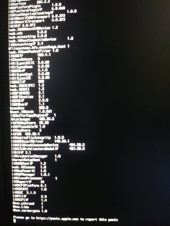

beatthecatagain Posted August 29, 2018 Share Posted August 29, 2018 [/img] Eu so tenho as opcoes que estao na print attached. A opcao intelgfx eu nao encontrei em lugar nenhum. Eu tambem ja tentei com a fakeid 0x12345678 selecionada ou nao. Added in 4 minutes 31 seconds: Eu tava ate feliz quando a instalacao passou. Durou pouco hahahahaha Isso que e estranho. Se fosse o video, a instalacao na parte grafica tambem nao teria funcionado nao? Added in 12 minutes 20 seconds: E neste print e que da o reboot ou panic Quote Link to comment Share on other sites More sharing options...

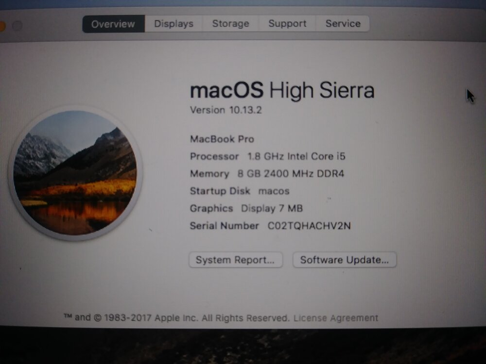

beatthecatagain Posted August 29, 2018 Share Posted August 29, 2018 Ok, I have had some success. Eu mudei de macbookpro11 para macbookpro14,2 Eu tambei fiz outras alteracoes na placa de video. Finalmente completou o boot e a instalacao. Mas agora eu tenho 7mb de video lol. Added in 1 minute 41 seconds: Depois da instalacao Quote Link to comment Share on other sites More sharing options...
Administrators MaLd0n Posted August 29, 2018 Author Administrators Share Posted August 29, 2018 sim, agora vc precisa usar o app e gerar a config Quote -Donations- PayPal HERE - Stripe HERE - Ko-Fi HERE - BuyMeaCoffee HERE - Mercado Livre HERE Skrill danielnmaldonado@gmail.com BTC 1BDzsV4bw3DVCiffFAeNKsdEzqkPXNVrXR ETH BSC BEP20 0xb57cfdfa371fad1981910f0e8332409ab99f74d9 BNB 0x10D1d656eCa00bD521f9b4A43B83098B8142e115 USDT BSC BEP20 0xb57cfdfa371fad1981910f0e8332409ab99f74d9 USDT TRC20 TUR6Z9AVS4AYzqPnULoHrfFvppRbhXmNbZ PicPay @danielnmaldonado PiX @danielnmaldonado@gmail.com Problems with Paypal HERE Sign up for a Bybit account and claim exclusive rewards HERE New ways to earn money with Linkvertise HERE Link to comment Share on other sites More sharing options...
