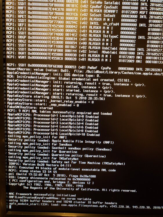

mbrogan30 Posted November 9, 2018 Share Posted November 9, 2018 I reset the bios and tried it without making any changes and it still will not boot the usb. I changed the bios settings back to settings advised and tried it again. It has error no nvram variable. Added in 2 minutes 34 seconds: I have seen a few people claiming to install hackintosh on this motherboard but, I can't find any proof of it. Maybe I should just purchase another motherboard? I have had hackintosh for a long time and never had this problem. I am thankful for people like you to help out. Thanks for what you do. Added in 3 minutes 40 seconds: Donated you a beer! Cheers Quote Link to comment Share on other sites More sharing options...
Administrators MaLd0n Posted November 9, 2018 Author Administrators Share Posted November 9, 2018 [ref]mbrogan30[/ref], try CLOVER.zip if don't work, use npci=0x2000 Quote -Donations- PayPal HERE - Stripe HERE - Ko-Fi HERE - BuyMeaCoffee HERE - Mercado Livre HERE Skrill danielnmaldonado@gmail.com - BTC 33HeGCuCSh4tUBqdYkQqKpSDa1E7WeAJQ3 - BNB 0x10D1d656eCa00bD521f9b4A43B83098B8142e115 - USDT BSC BEP20 0xb57cfdfa371fad1981910f0e8332409ab99f74d9 - USDT TRC20 TUR6Z9AVS4AYzqPnULoHrfFvppRbhXmNbZ - KASPA kaspa:qpxzufgfj8p6r0krg58yzvs0009h2mwqgvcawa0xc2pth7sgzpv56j4f6dtvk - PicPay @danielnmaldonado - PiX @danielnmaldonado@gmail.com Premium Users HERE - Problems with Paypal HERE Sign up for a Bybit account and claim exclusive rewards HERE New ways to earn money with Linkvertise HERE Link to comment Share on other sites More sharing options...

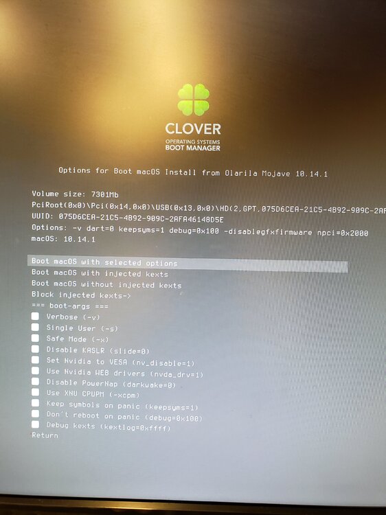

mbrogan30 Posted November 9, 2018 Share Posted November 9, 2018 Clover didn't work. I edited plist and tried. Here are the options preselected. What should have a check mark on it? Added in 1 minute 47 seconds: results are here. Thanks Quote Link to comment Share on other sites More sharing options...
Administrators MaLd0n Posted November 9, 2018 Author Administrators Share Posted November 9, 2018 [ref]mbrogan30[/ref], strange try to create a new USB Stick Quote -Donations- PayPal HERE - Stripe HERE - Ko-Fi HERE - BuyMeaCoffee HERE - Mercado Livre HERE Skrill danielnmaldonado@gmail.com - BTC 33HeGCuCSh4tUBqdYkQqKpSDa1E7WeAJQ3 - BNB 0x10D1d656eCa00bD521f9b4A43B83098B8142e115 - USDT BSC BEP20 0xb57cfdfa371fad1981910f0e8332409ab99f74d9 - USDT TRC20 TUR6Z9AVS4AYzqPnULoHrfFvppRbhXmNbZ - KASPA kaspa:qpxzufgfj8p6r0krg58yzvs0009h2mwqgvcawa0xc2pth7sgzpv56j4f6dtvk - PicPay @danielnmaldonado - PiX @danielnmaldonado@gmail.com Premium Users HERE - Problems with Paypal HERE Sign up for a Bybit account and claim exclusive rewards HERE New ways to earn money with Linkvertise HERE Link to comment Share on other sites More sharing options...
mbrogan30 Posted November 11, 2018 Share Posted November 11, 2018 I created a new usb and used your clover folder. It gives me the same results. No NVRAM. Any more ideas. I noticed on insanely mac someone had a motherboard like mine. You assisted them with their files. I'm not sure what I'm doing wrong. I am currently on Mojave on my other machine without any issues. Thanks for your help. Quote Link to comment Share on other sites More sharing options...
Administrators MaLd0n Posted November 12, 2018 Author Administrators Share Posted November 12, 2018 [ref]mbrogan30[/ref], for NVRAM u need a EmuVariableUefi-64.efi and OsxAptioFixDrv-64.efi try with -x for disable some things Quote -Donations- PayPal HERE - Stripe HERE - Ko-Fi HERE - BuyMeaCoffee HERE - Mercado Livre HERE Skrill danielnmaldonado@gmail.com - BTC 33HeGCuCSh4tUBqdYkQqKpSDa1E7WeAJQ3 - BNB 0x10D1d656eCa00bD521f9b4A43B83098B8142e115 - USDT BSC BEP20 0xb57cfdfa371fad1981910f0e8332409ab99f74d9 - USDT TRC20 TUR6Z9AVS4AYzqPnULoHrfFvppRbhXmNbZ - KASPA kaspa:qpxzufgfj8p6r0krg58yzvs0009h2mwqgvcawa0xc2pth7sgzpv56j4f6dtvk - PicPay @danielnmaldonado - PiX @danielnmaldonado@gmail.com Premium Users HERE - Problems with Paypal HERE Sign up for a Bybit account and claim exclusive rewards HERE New ways to earn money with Linkvertise HERE Link to comment Share on other sites More sharing options...

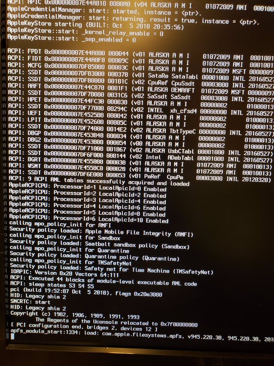

mbrogan30 Posted November 12, 2018 Share Posted November 12, 2018 Making progress. I downgraded the bios. It apparently won't work with the 3.30 bios. I downgraded to the 3.0. It now loads until its time for the apple logo and then it goes to a black screen. Any advice? Added in 2 minutes 2 seconds: It goes black right after it says DMOS has arrived Quote Link to comment Share on other sites More sharing options...
Administrators MaLd0n Posted November 12, 2018 Author Administrators Share Posted November 12, 2018 [ref]mbrogan30[/ref], is a video problem, uncheck InjectIntel or use -x Quote -Donations- PayPal HERE - Stripe HERE - Ko-Fi HERE - BuyMeaCoffee HERE - Mercado Livre HERE Skrill danielnmaldonado@gmail.com - BTC 33HeGCuCSh4tUBqdYkQqKpSDa1E7WeAJQ3 - BNB 0x10D1d656eCa00bD521f9b4A43B83098B8142e115 - USDT BSC BEP20 0xb57cfdfa371fad1981910f0e8332409ab99f74d9 - USDT TRC20 TUR6Z9AVS4AYzqPnULoHrfFvppRbhXmNbZ - KASPA kaspa:qpxzufgfj8p6r0krg58yzvs0009h2mwqgvcawa0xc2pth7sgzpv56j4f6dtvk - PicPay @danielnmaldonado - PiX @danielnmaldonado@gmail.com Premium Users HERE - Problems with Paypal HERE Sign up for a Bybit account and claim exclusive rewards HERE New ways to earn money with Linkvertise HERE Link to comment Share on other sites More sharing options...
