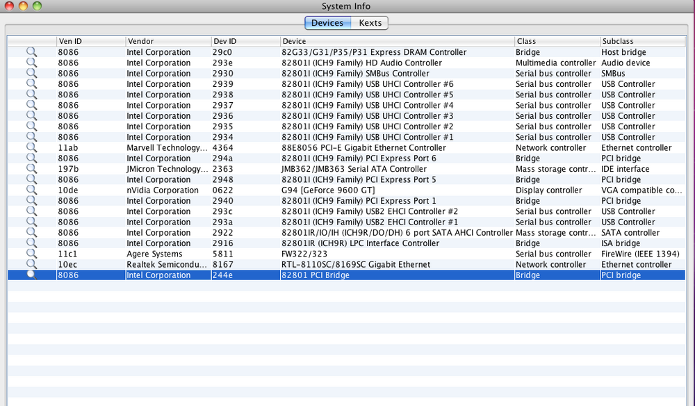

newtonsous Posted August 23, 2011 Share Posted August 23, 2011 Nem sei qual é a controladora, se você me disser, talvez eu tenha. Como faço Printscreen para te enviar uma imagem do System INFO? Quote Link to comment Share on other sites More sharing options...
oldnapalm Posted August 23, 2011 Author Share Posted August 23, 2011 http://Olarila.com/forum/viewtopic.php?f=2&t=66 Pode copiar e colar como texto mesmo. Quote Link to comment Share on other sites More sharing options...
newtonsous Posted August 23, 2011 Share Posted August 23, 2011 http://Olarila.com/forum/viewtopic.php?f=2&t=66Pode copiar e colar como texto mesmo. Quote Link to comment Share on other sites More sharing options...
oldnapalm Posted August 23, 2011 Author Share Posted August 23, 2011 http://nawcom.com/osx86/files/10.6/SATA/JMicron/ Quote Link to comment Share on other sites More sharing options...
newtonsous Posted August 23, 2011 Share Posted August 23, 2011 http://nawcom.com/osx86/files/10.6/SATA/JMicron/ DEU CERTO! VALEU MESMO... MAS ELA SÓ EJETA PELA TELA! MAS TD BEM... Quote Link to comment Share on other sites More sharing options...
