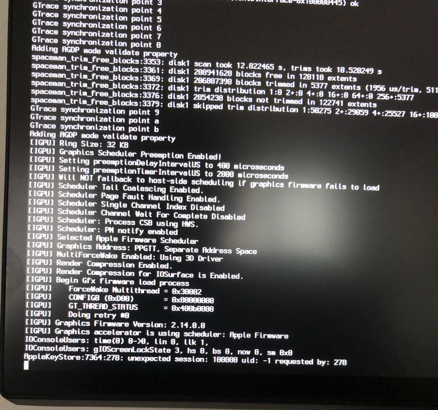

telepati Posted June 27, 2020 Share Posted June 27, 2020 I tried this on External SSD but I cant make a boot. After loading bar finished monitor signal losing. I added same EFI to SSD all boot arg include the NVRAM parameters but I cant make a boot. Here is the verbose; it doesnt stuck here its finishing and signal loss. @MaLd0n should I add these NVRAM parameters to my Catalina EFI/config.plist too? 1 Quote Link to comment Share on other sites More sharing options...

Administrators MaLd0n Posted June 27, 2020 Author Administrators Share Posted June 27, 2020 53 minutes ago, telepati said: @MaLd0n should I add these NVRAM parameters to my Catalina EFI/config.plist too? -igfxvesa and "reset nvram", boot into system and check solution about video 28 minutes ago, lzhoang2601 said: how to mount write with macOS Big Sur part? ? 7 minutes ago, longcoming said: I am getting "calling mpo_policy_init for lilu" error. u add things in NVRAM tab? 1 Quote -Donations- PayPal HERE - Stripe HERE - Ko-Fi HERE - BuyMeaCoffee HERE - Mercado Livre HERE Skrill danielnmaldonado@gmail.com - BTC 33HeGCuCSh4tUBqdYkQqKpSDa1E7WeAJQ3 - BNB 0x10D1d656eCa00bD521f9b4A43B83098B8142e115 - USDT BSC BEP20 0xb57cfdfa371fad1981910f0e8332409ab99f74d9 - USDT TRC20 TUR6Z9AVS4AYzqPnULoHrfFvppRbhXmNbZ - KASPA kaspa:qpxzufgfj8p6r0krg58yzvs0009h2mwqgvcawa0xc2pth7sgzpv56j4f6dtvk - PicPay @danielnmaldonado - PiX @danielnmaldonado@gmail.com Premium Users HERE - Problems with Paypal HERE Sign up for a Bybit account and claim exclusive rewards HERE New ways to earn money with Linkvertise HERE Link to comment Share on other sites More sharing options...
