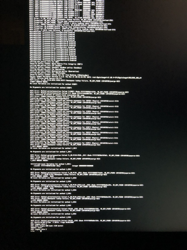

telepati Posted January 22, 2020 Share Posted January 22, 2020 @MaLd0n cant boot OC. I am getting this error; Attached EFI. EFI.zip Quote Link to comment Share on other sites More sharing options...
Administrators MaLd0n Posted January 22, 2020 Author Administrators Share Posted January 22, 2020 @MaLd0n cant boot OC dsdt from clover in some cases dont work with oc, is about fixregions/rebaseregions Quote -Donations- PayPal HERE - Stripe HERE - Ko-Fi HERE - BuyMeaCoffee HERE - Mercado Livre HERE Skrill danielnmaldonado@gmail.com - BTC 33HeGCuCSh4tUBqdYkQqKpSDa1E7WeAJQ3 - BNB 0x10D1d656eCa00bD521f9b4A43B83098B8142e115 - USDT BSC BEP20 0xb57cfdfa371fad1981910f0e8332409ab99f74d9 - USDT TRC20 TUR6Z9AVS4AYzqPnULoHrfFvppRbhXmNbZ - KASPA kaspa:qpxzufgfj8p6r0krg58yzvs0009h2mwqgvcawa0xc2pth7sgzpv56j4f6dtvk - PicPay @danielnmaldonado - PiX @danielnmaldonado@gmail.com Premium Users HERE - Problems with Paypal HERE Sign up for a Bybit account and claim exclusive rewards HERE New ways to earn money with Linkvertise HERE Link to comment Share on other sites More sharing options...
telepati Posted January 23, 2020 Share Posted January 23, 2020 dsdt from clover in some cases dont work with oc, is about fixregions/rebaseregions I changed rebaseregions NO but it didn't makes any difference. is problem DSDT or something else? You said this DSDT will work with OC am I got wrong? Quote Link to comment Share on other sites More sharing options...
Administrators MaLd0n Posted January 23, 2020 Author Administrators Share Posted January 23, 2020 I changed rebaseregions NO but it didn't makes any difference. is problem DSDT or something else? You said this DSDT will work with OC am I got wrong? u need use rebase, reboot and patched Quote -Donations- PayPal HERE - Stripe HERE - Ko-Fi HERE - BuyMeaCoffee HERE - Mercado Livre HERE Skrill danielnmaldonado@gmail.com - BTC 33HeGCuCSh4tUBqdYkQqKpSDa1E7WeAJQ3 - BNB 0x10D1d656eCa00bD521f9b4A43B83098B8142e115 - USDT BSC BEP20 0xb57cfdfa371fad1981910f0e8332409ab99f74d9 - USDT TRC20 TUR6Z9AVS4AYzqPnULoHrfFvppRbhXmNbZ - KASPA kaspa:qpxzufgfj8p6r0krg58yzvs0009h2mwqgvcawa0xc2pth7sgzpv56j4f6dtvk - PicPay @danielnmaldonado - PiX @danielnmaldonado@gmail.com Premium Users HERE - Problems with Paypal HERE Sign up for a Bybit account and claim exclusive rewards HERE New ways to earn money with Linkvertise HERE Link to comment Share on other sites More sharing options...

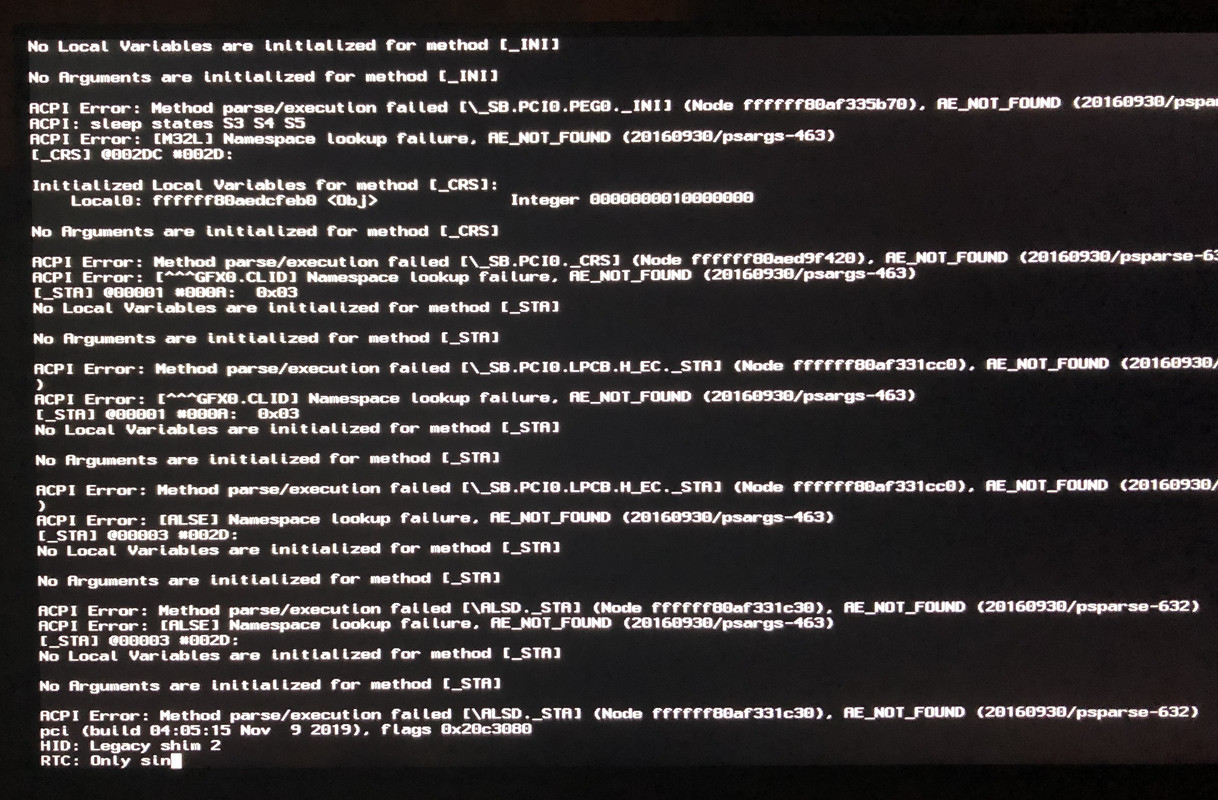

telepati Posted January 23, 2020 Share Posted January 23, 2020 u need use rebase, reboot and patched @MaLd0n I really dont got it what do you mean; I follow the your first page instructions; Download EFI to USB Add DSDT.aml and SSDT-4-xh_cfsd4.aml which you created I checked the config and Rebase already set"YES" When I boot I am getting this error; Quote Link to comment Share on other sites More sharing options...

Administrators MaLd0n Posted January 23, 2020 Author Administrators Share Posted January 23, 2020 @MaLd0n u need boot with oc without dsdt and with rebase regions and patch new dsdt Quote -Donations- PayPal HERE - Stripe HERE - Ko-Fi HERE - BuyMeaCoffee HERE - Mercado Livre HERE Skrill danielnmaldonado@gmail.com - BTC 33HeGCuCSh4tUBqdYkQqKpSDa1E7WeAJQ3 - BNB 0x10D1d656eCa00bD521f9b4A43B83098B8142e115 - USDT BSC BEP20 0xb57cfdfa371fad1981910f0e8332409ab99f74d9 - USDT TRC20 TUR6Z9AVS4AYzqPnULoHrfFvppRbhXmNbZ - KASPA kaspa:qpxzufgfj8p6r0krg58yzvs0009h2mwqgvcawa0xc2pth7sgzpv56j4f6dtvk - PicPay @danielnmaldonado - PiX @danielnmaldonado@gmail.com Premium Users HERE - Problems with Paypal HERE Sign up for a Bybit account and claim exclusive rewards HERE New ways to earn money with Linkvertise HERE Link to comment Share on other sites More sharing options...

telepati Posted January 24, 2020 Share Posted January 24, 2020 u need boot with oc without dsdt and with rebase regions and patch new dsdt Ok, I got it now what do you mean. I installed your first post EFI and add to Bootable USB Stick(No DSDT just your first post-EFI) and reboot click F8 and choose USB and OC boot screen came and chose my Clover Catalina disk, verbose starts, and machine reboot. I tried several times and it looks like reboot loop. I took send-me from Clover without DSDT; is this can be help for OC DSDT or I must force the boot with OC? http://s000.tinyupload.com/index.php?file_id=07079951604495968640 Quote Link to comment Share on other sites More sharing options...
