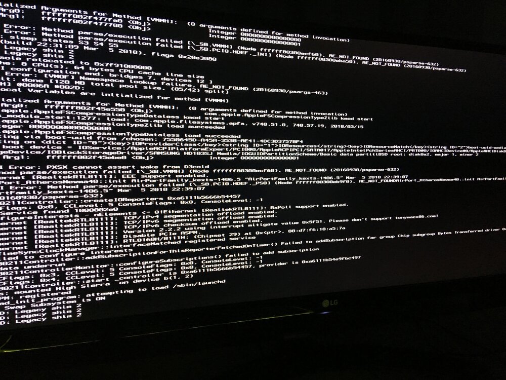

alienware Posted April 14, 2018 Author Share Posted April 14, 2018 Seria essa a pasta? Quote Link to comment Share on other sites More sharing options...
Administrators MaLd0n Posted April 14, 2018 Administrators Share Posted April 14, 2018 Sim Quote -Donations- PayPal HERE - Stripe HERE - Ko-Fi HERE - BuyMeaCoffee HERE - Mercado Livre HERE Skrill danielnmaldonado@gmail.com - BTC 33HeGCuCSh4tUBqdYkQqKpSDa1E7WeAJQ3 - BNB 0x10D1d656eCa00bD521f9b4A43B83098B8142e115 - USDT BSC BEP20 0xb57cfdfa371fad1981910f0e8332409ab99f74d9 - USDT TRC20 TUR6Z9AVS4AYzqPnULoHrfFvppRbhXmNbZ - KASPA kaspa:qpxzufgfj8p6r0krg58yzvs0009h2mwqgvcawa0xc2pth7sgzpv56j4f6dtvk - PicPay @danielnmaldonado - PiX @danielnmaldonado@gmail.com Premium Users HERE - Problems with Paypal HERE Sign up for a Bybit account and claim exclusive rewards HERE New ways to earn money with Linkvertise HERE Link to comment Share on other sites More sharing options...
alienware Posted April 14, 2018 Author Share Posted April 14, 2018 Foi essa pasta CLOVER da imagem que substitui pela CLOVER que me enviou, chegou a ver o último RunMe que te enviei? Quote Link to comment Share on other sites More sharing options...
Administrators MaLd0n Posted April 14, 2018 Administrators Share Posted April 14, 2018 Foi essa pasta CLOVER da imagem que substitui pela CLOVER que me enviou, chegou a ver o último RunMe que te enviei? agora foi testa o audio, sleep etc Quote -Donations- PayPal HERE - Stripe HERE - Ko-Fi HERE - BuyMeaCoffee HERE - Mercado Livre HERE Skrill danielnmaldonado@gmail.com - BTC 33HeGCuCSh4tUBqdYkQqKpSDa1E7WeAJQ3 - BNB 0x10D1d656eCa00bD521f9b4A43B83098B8142e115 - USDT BSC BEP20 0xb57cfdfa371fad1981910f0e8332409ab99f74d9 - USDT TRC20 TUR6Z9AVS4AYzqPnULoHrfFvppRbhXmNbZ - KASPA kaspa:qpxzufgfj8p6r0krg58yzvs0009h2mwqgvcawa0xc2pth7sgzpv56j4f6dtvk - PicPay @danielnmaldonado - PiX @danielnmaldonado@gmail.com Premium Users HERE - Problems with Paypal HERE Sign up for a Bybit account and claim exclusive rewards HERE New ways to earn money with Linkvertise HERE Link to comment Share on other sites More sharing options...

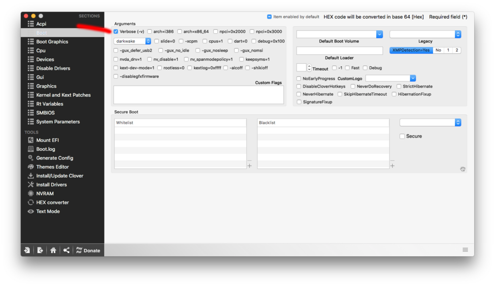

alienware Posted April 14, 2018 Author Share Posted April 14, 2018 Com fone funcionou. Amanhã vou testar com Caixa de som, hoje estou sem pra testar...antes de tentar essa Kext. Sobre estar iniciando ainda em verbose, tem como arrumar? Quote Link to comment Share on other sites More sharing options...
Administrators MaLd0n Posted April 14, 2018 Administrators Share Posted April 14, 2018 só desmarcar o verbose -v no config.plist Quote -Donations- PayPal HERE - Stripe HERE - Ko-Fi HERE - BuyMeaCoffee HERE - Mercado Livre HERE Skrill danielnmaldonado@gmail.com - BTC 33HeGCuCSh4tUBqdYkQqKpSDa1E7WeAJQ3 - BNB 0x10D1d656eCa00bD521f9b4A43B83098B8142e115 - USDT BSC BEP20 0xb57cfdfa371fad1981910f0e8332409ab99f74d9 - USDT TRC20 TUR6Z9AVS4AYzqPnULoHrfFvppRbhXmNbZ - KASPA kaspa:qpxzufgfj8p6r0krg58yzvs0009h2mwqgvcawa0xc2pth7sgzpv56j4f6dtvk - PicPay @danielnmaldonado - PiX @danielnmaldonado@gmail.com Premium Users HERE - Problems with Paypal HERE Sign up for a Bybit account and claim exclusive rewards HERE New ways to earn money with Linkvertise HERE Link to comment Share on other sites More sharing options...

alienware Posted April 14, 2018 Author Share Posted April 14, 2018 Ok! Tirei o verbose e o sistema subiu. Só notei que a primeira tela da maçã, antes de carregar o sistema, ficou meio desfigurada. O reiniciar do sistema funcionou, o repouso quando volta pede senha e até agora funcionando e o desligar também funcionando. Sobre esses testes estava se referindo? Quote Link to comment Share on other sites More sharing options...
