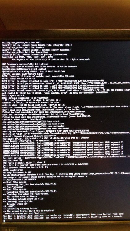

Now I got kernel panic with this kext and dsdt.aml , pic attached. (just for checking, should I keep my kext or change all of them for the ones you send me? DSDT goes to ACPI -> Patched, right?

remove appleigb kext
if u use in clover/kexts/... u can press barspace and block kexts
Blocking the Kext I was able to boot but now with no USB working, even for the keyboard or mouse to work :/
I removed now the AppleIGB, its booting normally but when at login screen i cant use mouse or keyboard!
With the AppleIGB the kernel panic is this:

ur system is corrupted, need a repair, if u use HFS, use DiskWarrior

Ok, already repaired, but still stuck in login screen without keyboard and mouse input, ive tried all usb inputs but nothing.
