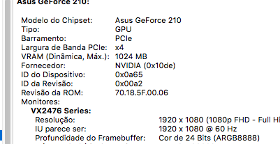

hanks you! You can help me patch it or how to patch it with some patchs you post. Sr, my english is bad . Thanks you in advanced.
Send me Nguyens-MBP.net.fpt.zi
put ur gpu in first slot, work at 4x only, bad
CLOVER.zip
