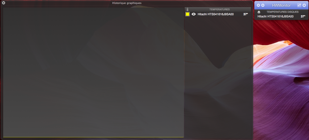

paulopina Posted December 31, 2013 Author Share Posted December 31, 2013 Hello No problems dude, every day many people come here talking that installed OSX following the guides of tonycrap or myhack, but the real problem isn't in installtion, the real problem is in post-installation. Remove all those kexts. Install FakeSMC: http://Olarila.com/files/10.8/HWSensors/FakeSMC.kext.zip and NullCPUPM to fix power management: http://Olarila.com/files/10.6/PM/NullCPUPowerManagement.kext.zip Did Myhack install Chameleon as bootloader? You can continue your post-installation, but my advice is that you re-install OSX and follow this guide: http://Olarila.com/forum/viewtopic.php?f=28&t=1716 Don't worries, read carefully and undestand, if you have a question me and others uses will help you. I didn't undestand this, but distro=modified OSXretail=Original OSX without modified(only include some kext and a bootloader to boot) You have a good english YES Myhack install Chameleon as boot loader. You need to understand this first: When i use Myhack method, i put the extensions in E/E I run "myhack.app", it create "myhack.kext" in S/L/E, in the content it place all extensions from E/E But if i don't want to use Myhack method, I use Kext Utility to put extensions in S/L/E, before i delete "myhack.kext" in S/L/E and all extensions in E/E Now i can explain this below: When i install FakeSMC Without plugins Run HWMonitor.app you can see only the hard drive temperature Quote Link to comment Share on other sites More sharing options...

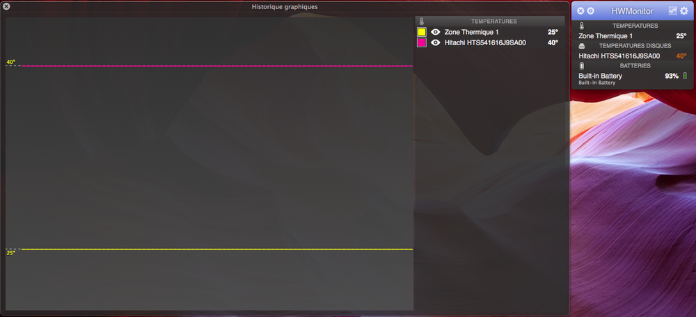

paulopina Posted December 31, 2013 Author Share Posted December 31, 2013 When i install FakeSMC With acpi plugins Run HWMonitor.app you can see the hard drive temperature, a new thermic area, and the most important the battery Quote Link to comment Share on other sites More sharing options...

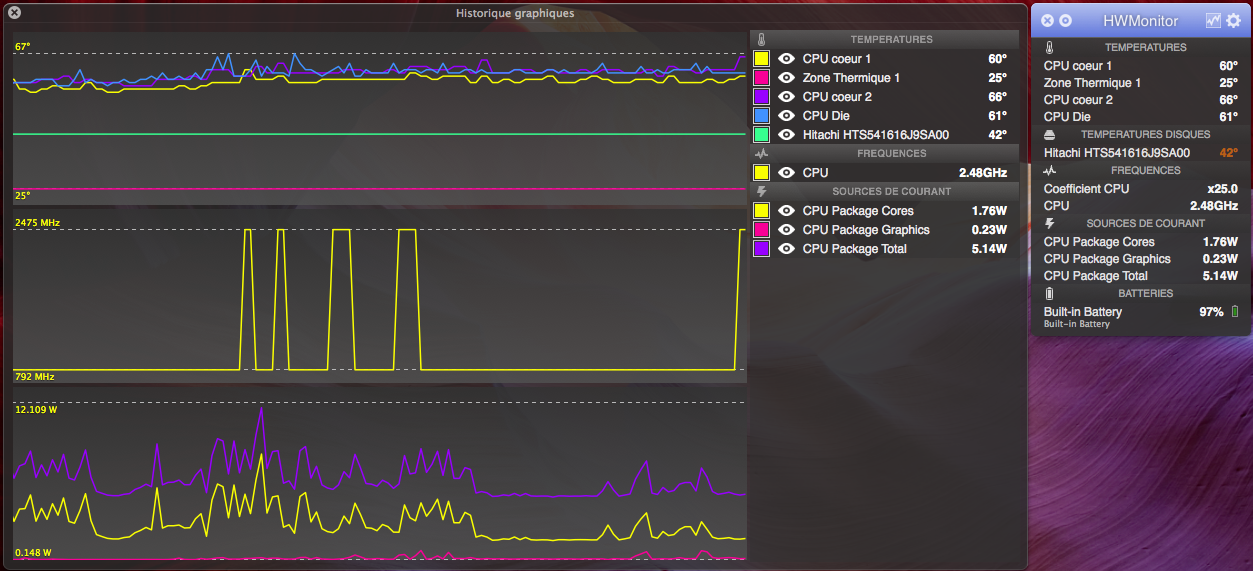

paulopina Posted December 31, 2013 Author Share Posted December 31, 2013 When i install FakeSMC With acpi and cpu plugins Run HWMonitor.app you can see the hard drive temperature and a thermic area, the battery and now alls CPU temperature and frequency The CPU coefficient is 25, the frequency 2,48GHz, it is the max for the moment, because turboboost doesn't work. Quote Link to comment Share on other sites More sharing options...

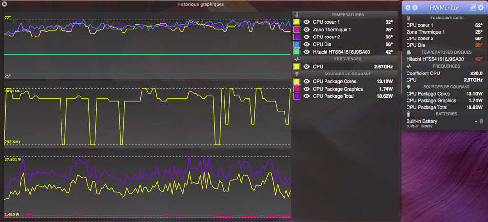

paulopina Posted December 31, 2013 Author Share Posted December 31, 2013 Now to enable the CPU turbo boost i add this kext: DisableTurboBoostBattery.kext if i use NullCPUPowerManagement it doesn't work, it work with AppleIntelCPUPowerManagement Look HWMonitor now: The CPU coefficient up until 30, the frequency 2,97GHz, because turboboost work now. Pay attention, it's work for me because i have edit a correct DSDT.aml and SSDT.aml. Quote Link to comment Share on other sites More sharing options...
PimentelX86 Posted December 31, 2013 Share Posted December 31, 2013 Hello Why many post to same goal? So put FAkeSMC+necessary plugins. You don't need kext DisableTurboBossBattery... I recommended the NullCPUPM until you have power management, then you have to remove it To activavte power management you need: *SSDT generated by pike's script *patch AICPUPM *DSDT(if you want, but is recommended) *DropSSDT=Yes(activated in org.chameleon...) *C e P States=No *Remove NullCPUPM AppleIntelCPUPowerManagement Already in S/L/E natively, the AICPUPM given by Myhack doesn't work 100%, you must use the AICPUPM that came with the system installed Quote Link to comment Share on other sites More sharing options...
