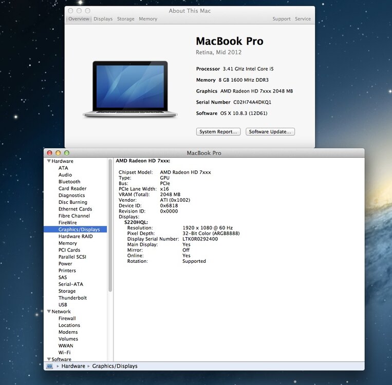

xsmile Posted January 23, 2013 Author Share Posted January 23, 2013 Use this tool and read the first few posts carefully. http://www.insanelymac.com/forum/topic/285444-pmpatch-uefi-patching-utility/ Quote 10.9 @ Asus P8Z77-V LK [ALC892, ASM1042, RTL8168], Core i5-3570k, XFX HD 7870 Link to comment Share on other sites More sharing options...

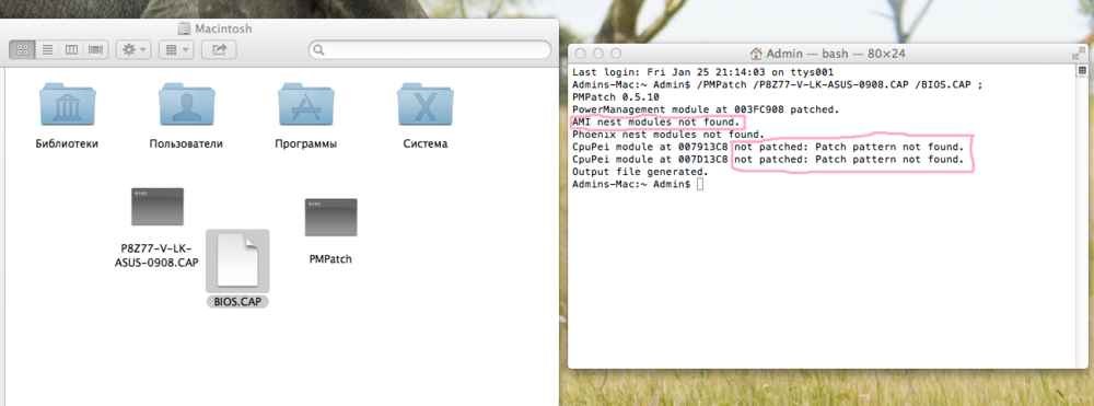

nekitXD Posted January 25, 2013 Share Posted January 25, 2013 Use this tool and read the first few posts carefully.http://www.insanelymac.com/forum/topic/285444-pmpatch-uefi-patching-utility/ I'm trying to flash my bios with patched .CAP file. Asus EZ flash refused to flash my bios... PS. This is normal? (attached photo) Quote Link to comment Share on other sites More sharing options...
xsmile Posted January 25, 2013 Author Share Posted January 25, 2013 Yes. It just needs to patch the PowerManagement module and this was done and logged in the first line. Read this: http://www.applelife.ru/threads/%D0%9F%D0%B0%D1%82%D1%87-%D0%91%D0%B8%D0%BE%D1%81%D0%B0-uefi-%D0%A1%D0%B5%D1%80%D0%B8%D0%B8-%D0%90sus-p8xxx.34578/page-15#post-314986 Quote 10.9 @ Asus P8Z77-V LK [ALC892, ASM1042, RTL8168], Core i5-3570k, XFX HD 7870 Link to comment Share on other sites More sharing options...
nekitXD Posted January 25, 2013 Share Posted January 25, 2013 Yes. It just needs to patch the PowerManagement module and this was done and logged in the first line.Read this: http://www.applelife.ru/threads/%D0%9F%D0%B0%D1%82%D1%87-%D0%91%D0%B8%D0%BE%D1%81%D0%B0-uefi-%D0%A1%D0%B5%D1%80%D0%B8%D0%B8-%D0%90sus-p8xxx.34578/page-15#post-314986 Thank you! Quote Link to comment Share on other sites More sharing options...
